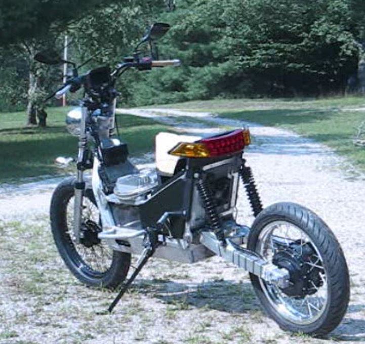

Here is my entry into the "Franken-bike" arena. :-P ... it is based upon a Vectrix Vx-1 frame and ICM-CANbus
(( can't use the frame in the picture because it is bent but it makes a good template from which to start :-(
... which is why I am in search of another VX-1 )).
Ok... What we have here is a Yamaha front end, Vectrix VX-1 Frame, and a dirt bike swing-arm with Enertrac hub-motor.
so a?: YAM-TRIX-IRT or maybe a VECT-IRT-MAHA... :-)) but I have dubbed it the RAVEN-PT1 (( PT for ProtoType )).
My driveway is over 700' (215 meters) long and on the initial ride the bike was able to get up to 40mph (65kmph) but this is
just a preliminary indication as the speedometer may yet need to fine tuned. ...anyway...
