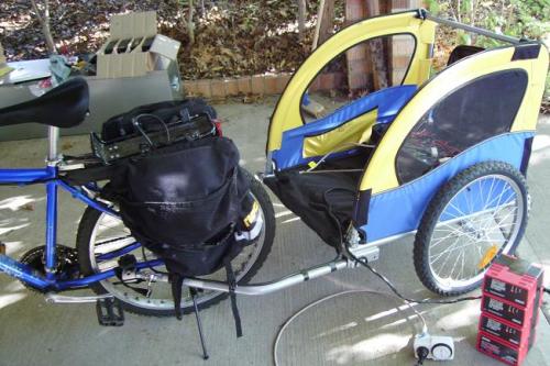

Re: What about a trailer?
UPDATE.
heres the test vehicle with trailer attached.
Note: the side bars on the trailer have been installed under the frame to re-enforce it so it can hold the SLA load.
Here is the battery pack conveniently placed in a small travel bag with stereoscopic handle and wheels so it can be easily moved around.
The bag neatly holds 12 12V 7 AH SLA batteries.
the batteris are grouped in parallel lots of 3 for fast charging.
A 48 volt charger constructed from 4 cheap 12 volt chargers.
Each 12 volt charger connects to 3 SLA batteries.
the battery bank is connected to the Charger via a single 8 pole plug.
break down of costs.
Tralier: $135
SLA batteries: $6 from recycling centre.
IEC cables pulled form computers found at the recycling centre. $2
Connectors: $25
Chargers: 4 x $25 = $100
total cost: $268 AUD.. approx $250 USD
Note: all components can be purchased from your local cheap auto store.
Motor: Crystalyte 408
Battery weight: 30KG or 66 Pounds.
Top Speed on flat: 35Kph or 21.5 Mph.
Range using second hand batteries in hilly teritory. 12 KM or 7.5 Miles.
Verdict.
The bike is more stable when the batteries are put in the trailer instead of the back of the bike. However you must take care turning sharp corners.. I did this once and the pack flew out and toppled the trailer... oops...
the trailer is adequate for handling the load and speeds put on it.. however I probably wouldn't put much more on it.
bigger wheels might help carry more load but they would also raise the centre of gravity of the battery pack making it much easier to topple over when taking corners.
this is a good way to boost your ebike range for 15-20 KM..
even better if you used NIMH or LifePo4...
