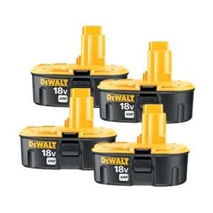

You could also double the battery pack, using diodes to direct the voltage. Both batteries have to be the same voltage. It does not matter if both battery packs use a different technology or not. Because of space constraints, it might be better to use the smallest battery pack available (@48V) even if it's a LEAD ACID battery pack.
In fact, with the diodes you have a 3V drop over them, so using 3 18V powerdrill batteries in series (total of 54V) should still work.
Best batteries for this purpose are NiMh batteries, as they are kind of lightweight, have plenty of power, and aren't too expensive.
You also need to utilize them until they're completely empty.
The negative about these batteries is that they get empty after a week of no use.
either 3x18v in series for 54V:
=3x$33=$100
or 2x24V in series for 48V:
=2x$96=$194
Using 3x18V in series makes more sense economically.
If you use 2 the same type batteries in the bike, or 2 batteries with the same voltage rating, just use one diode (or a few in series to increase the amps) on the positive terminal of the internal battery, just not to lose too much voltage. It's not necessary to use diodes on both positive and negative terminal,as one terminal is enough.
If you are using different technologies, different voltages, eg: 2 rows of 3x18V in series of power-drill batteries, it is wisest to equip only those 18 volters with diodes, both on the positive and negative terminal. It gives greater protection, but also greater voltage drop off. In fact, it is wisest to put a diode between each battery, and finally 2 diodes to top off the complete pack.
This method will give you a bit higher torq, while also giving you longer driving distance per charge.

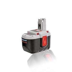

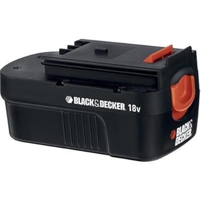

My experience with NiMh batteries from Black and Decker is that they are the cheapest, but they also run empty very fast,even when not in use.
It may be cheaper to buy batteries in packs. DeWalt sells 4 of them for $200,which is not too cheap, but my experience with their products have always been good, and having 4 gives you 1 extra battery for when one breaks down!
This 3x18V is pretty expensive, but much smaller and lighter than finding a 48V lead acid battery with larger capacity, though if a lead acid battery fits in the storage compartment, it is a better solution for extending range.

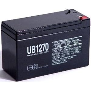

For $250 you can get these batteries:
http://www.x-tremescooters.com/electric_bicycles/xb502/parts.html
The box is too big to fit in the luggage compartment, but the good thing is that the box has 4 12V, 12A batteries in them.
You can easily take them out, and stack them inside the helmet compartment.
For about $48 you can install 3 of these home security batteries, 12V,5Ah.
A much better solution than the hand drill batteries. If they only fit the compartment.
The specs are not online on amazon, but I've seen from http://www.wholesalebatteriesdirect.com, that they are 2.76 x 3.54 x4.32.
Now, if you're really short on cash, for about $25 (that's 3 of these) you can install these lead acid batteries:
http://www.amazon.com/Volt-Alarm-Battery-12v5ah-Hour/dp/B0010Z4MDK
I don't know the size, but seriously, $25? That's a steal!
I don't know how large they are, they seem pretty small to me, and if they fit or not fit in the trunkspace I don't know.
But they should increase your torq a bit, and your range by about 5-10miles!

uh, ignore last picture above,
They charge $6,99 shipping, so turns out the cheapest solution is $47.
Man I hate a forum where I can't correct my posts!
I have to figure out if it's more beneficial to put 3x home security batteries in the trunk, or change them to PSU batteries.
The PSU batteries have 7A instead of 5A, but are a bit larger
5.9 x 2.5 x 3.9 inches ; 5 pounds each
http://www.amazon.com/GS-Portalac-PX12072-Replacement-Terminals/dp/B004ALBUYU/ref=sr_1_51?ie=UTF8&qid=1337540871&sr=8-51
@$17,99 they seem to be a better deal (price/capacity wise), as long as they fit in the trunk space of the bike.
For the same lithium batteries you'll be paying $108.
I think a better way to determine batteries is see how much trunk space each bike has, and buy the batteries depending on the trunk space.
