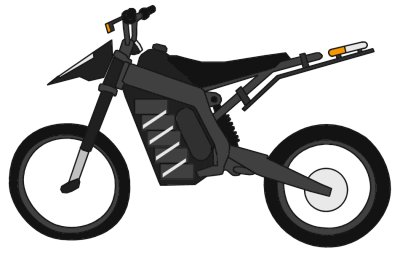

Rough Design Concept
//www.captainslug.com/temp/nem0_concept.jpg)
I intend to make it road-worthy, even though it will be operating within a DMV loophole that prevents it from needing a license plate or insurance. So it will include lights, turn signals, and horn, albeit custom-made ones.

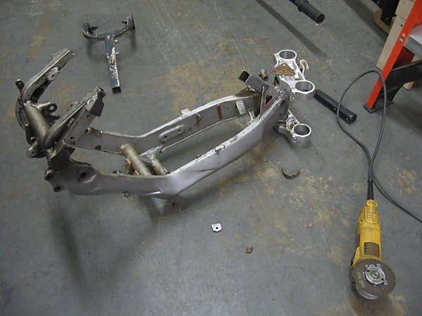

It's finally above freezing for the first time in a month. A toasty 54F. It's so "warm" I was able to work the ice out of the garden hose.
Parts everywhere. The parts on the far right won't be needed (fuel tank, exhaust, muffler, engine brackets).
//www.captainslug.com/temp/nem0_001.jpg)
Frame is pretty filthy.
//www.captainslug.com/temp/nem0_002.jpg)
I can only get is so clean with dish soap, water, and a brush.
I'll have to clean it further by sand-blasting it. But for now it's clean enough to start cutting and welding.
