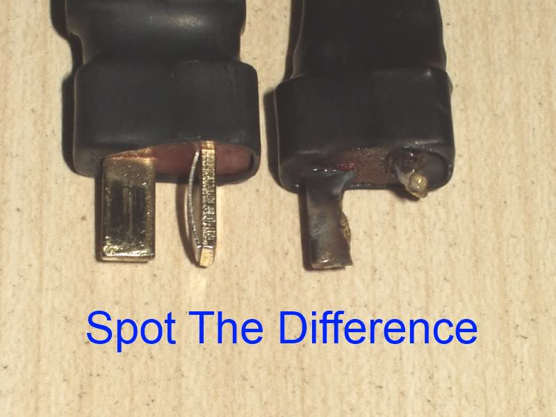

I have also experienced the nice loud bang that can occur when you accidentally short out a LiPo pack with no fuse protection whilst trying to video the aforementioned spark between two male connectors!

    Matteo suggested that the rear sensors might be OK, but when I plugged just the rear sensors in, the charging and gauge problem immediately returned.
    This is a poor quality picture of one of the two sensor modules on the rear battery pack which doesn't look very healthy to me:
    If the other sensors in the pack are in this sort of condition (or perhaps worse) it might explain why the charger doesn't like being connected to them.
