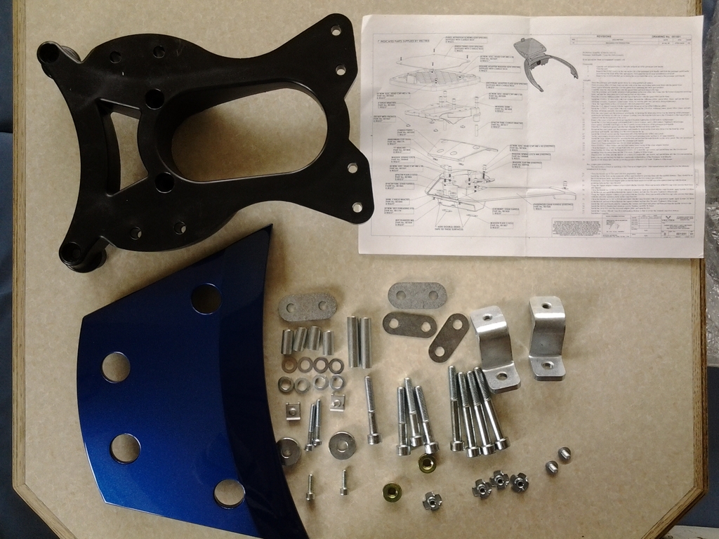

I have a top case mounting bracket for a Vectrix VX-1 that I'm giving away if anyone is interested. I took this off of my 2007 Vectrix which I recently gave away. The back plate is dark green. I've attached a picture of the bracket and all the associated hardware.
All I ask is that you pay for actual shipping costs (via PayPal). If you are in the California Bay Area, you could come pick it up.

When I looked at Larry's photo there appeared to be several missing bits compared to the complete kit that I ended up buying, but as you already have yours fitted, you must already have all the necessary bits.
How did yours break? Did it have anything to do with being overloaded and then thrashing it round the bumpy Isle of Mann TT course at 70mph?
Any chance you can post some picture of the breakage so I can see where additional support may be advantageous?

As promised, here is a close up of the split on my top mount. It has happened to both the front mount holes so it is time to replace it now. So the cautionary tale here is not to over tighten the bolts or they will split the mount.
It's worse than I first thought :-(
20150620_111054 (360x640).jpg20150620_111104 (360x640).jpg20150620_111112 (360x640).jpg20150620_111915 (640x360).jpg20150620_111957 (640x360).jpg
Water has got into the mounting bolt sleeves - rusted them, they've expanded and split the plastic mounting frame. Definitely time for a new kit and this time I will use more copper lube to prevent water damage. To top it all off I am now going to have to replace the entire grab rail as it has snapped on both sides.
