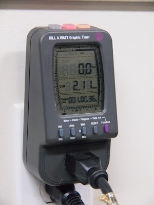

An update: I passed 3k miles today. Woohoo!
Unfortunately, I can't claim to have passed that mark without problems. A new issue cropped up this weekend: the charger is terminating the bulk charge phase before the battery is actually full. I put in 1.4 kWh after 24 miles of riding, which isn't nearly enough given the way I ride. Apparently, there's some sort of noise between the charger and the BMS causing it to halt early. Fortunately, the guys at Current not only knew what was going on, but are already testing a fix this week. I hope to have an update on that in a few days.
However, in the mean time, I strongly recommend that every electric vehicle owner get one of these:
Kill-a-Watt Timer
It's a Kill-a-watt with a digital timer. If you can make it out, the screen is showing that I've consumed 2.11 kWh since I last reset it. This is an excellent tool for keeping track of how much electricity you actually consume on each recharge cycle, which you can then compare against your miles ridden. The nice thing about this particular model is that it also functions as a timer, so I have mine set to begin the recharge cycle at midnight, and continue until just before I depart for work in the morning. This provides less stress on the electrical grid, since you're drawing off-peak power, as well as allowing your batteries to charge in the cool part of the night. You can view the charger's draw in watts or amps, and verify the voltage of your grid, and there's also a bit of a surge suppression function. Get one.

Congrats on the 3K milestone!
On the Kill-A-Watt (KaW) front I very much agree with Mike B. A KaW is a great tool for keeping an independent measure of efficiency, health of batteries etc. It's not a requirement - but it is a VERY useful tool for any EV'er. For those on a budget (or if you're just cheap like me) keep an eye open for the P4400 model. It's the "old version" (the newer version has some non-volatile memory on it whereas this one looses it's data as soon as you unplug it). I find these work well and I recently found them for as little as $16 each... (I think I paid $40 the first time I bought the P4400 when it was just out).
For those who care about the details the charging issue seems to be a varying amount of noise coming from the charger. Unfortunately this noise is causing the voltage sensing circuitry to read high - resulting in early termination. We are fitting an opto-isolator in this circuit at the charger end - it will be a plug in upgrade sent out to existing owners. In fact there's already this circuitry in the BMS - but there's far more noise now being seen than we expected and for some yet-to-be determined reason (a) new chargers suffer it sooner than old chargers but (b) old chargers seem to begin suffering it after some undetermined amount of time.
p.s. note that this failure "fails safe". There's no damage to the battery pack. The LVC circuitry in the BMS isn't affected (because here's no charger induced noise when riding the bike)
