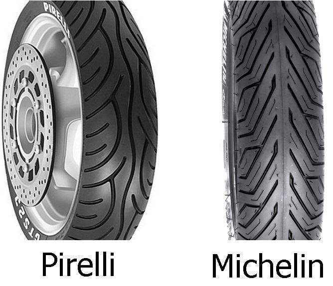

If you look at the Pirelli tyre that is fitted to the Vectrix, you will notice that it has a continuous wavy line right around the centreline of the tyre:
//www.arhservices.co.uk/GoldenMotor/Vectrix/Tyres_zpsubt5ovwg.JPG)
I think the wavy line causes a slight side to side pressure variation between the tyre and the road surface as it rotates which could induce steering wobble if combined with a sensitive castor steering effect at the right frequency. Whereas in comparison, the Michelin tyre has a 1/2" wide solid section directly around the centre of the tyre, which should help it to roll nice and straight producing a well centred castor action.
I will try to explain my theory, which is purely based on observation and experience. I have no actual proof of this whatsoever, but I am convinced that the wavy line is the culprit.
If you placed a laterally balanced loose wheel with a Pirelli tyre in an upright position on a level flat surface it should try to tip one way or the other depending on which side of the centreline the gap of the wavy line was positioned.
So, if the typical contact width of the tyre in an upright position is say 1/2" and you have a 1/4" gap on one side of the centre line and 1/4" of rubber on the other side it must have an adverse affect the steering as all the force is acting to one side of the centre line, and as the tyre rotates, the exerted force on the tyre moves across the centre line to the opposite side.
Although it now seems very obvious to me, it's very difficult to try and explain in writing what is actually happening where the wavy line meets the road surface.
I hope you've been able to understand at least some of what I've tried to explain.
Great explanation!
It was perfectly understandable for me!

For anyone who was not able to understand my initial explanation, imagine riding along a 3mm wide steel guide rail which causes the steering to go from side to side as the wavy groove in the tyre is persuaded to follow the straight line path of the fixed guide rail.
I realise it's not really the same, but I think the resultant shimmying effect on the steering/handlebars would be similar.

Bikemad, your explanation is clear to me too, but I have my doubts about it: if the wave pattern is the culprit, its "frequency" should match the frequency of the wobble of the handlebars. Now, I have no way to measure the handlebar wobble frequency, but I think it is slower than the wobble that would be caused by the front wheel's curvy thread pattern. Of course, it could be reacting to a "harmonic" (i.e., a multiple) of that frequency...
But in my case, I just found out that my rear rim is slightly bent sideways and it's rotational frequency seems more like what the handlebars are doing. I'll be replacing the rear tire/rim soon and report back if that changes anything.
I don't doubt the Michelins ride smoother - the Pirelli GTS have an obvious oscillating pattern of "hills and valleys" along the curvy center groove, if you look tangentially at them (sorry for the "tech-speak")...
