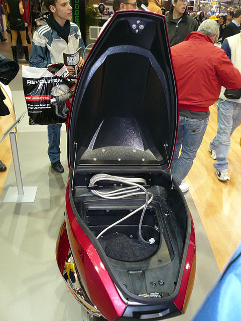

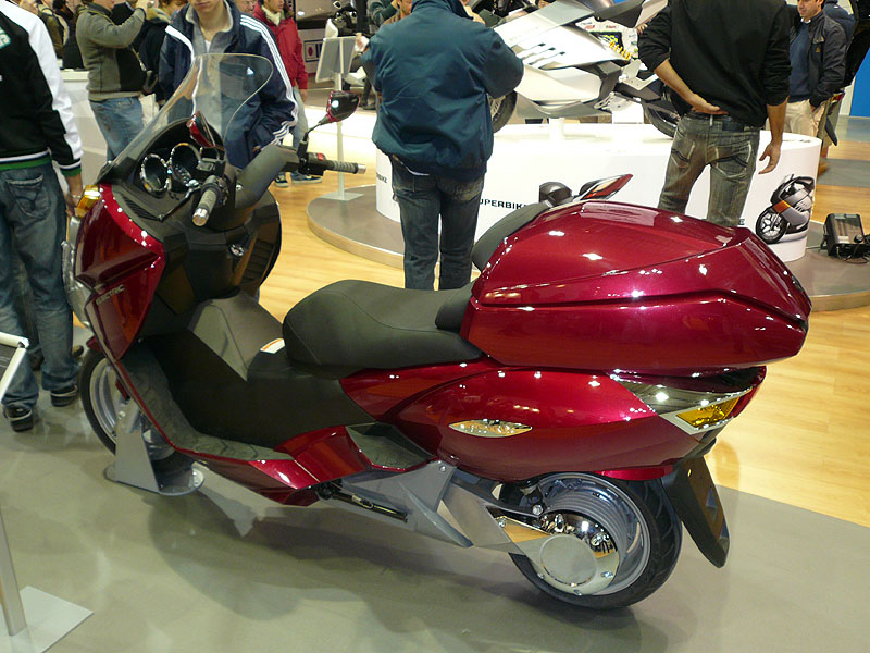

2.) Vectrix was prototyping a trunk, which replaced the rear seat, and opened into the original trunk space. With all the financial issues circling around the company these days, you can pretty much forget that being a purchasable option any time soon.
Here's a few shots of the trunk on display at an expo a while back:
http://www.moccsplace.com/vectrix/trunk/scooter1400x300.jpg
http://www.moccsplace.com/vectrix/trunk/vectrix-topcaselarge.jpg
http://www.moccsplace.com/vectrix/trunk/Vectrix_Topcase.jpg
http://www.moccsplace.com/vectrix/trunk/vectrixtrunkfrontviewem.jpg
http://www.moccsplace.com/vectrix/trunk/vectrixtrunksideview.jpg

Oh- Great!
Those are the pictures I was looking for.
