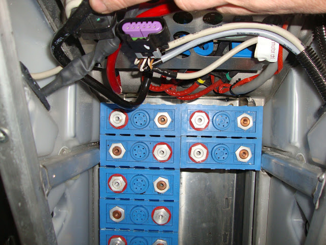

Old batts out, playing with fit of the new ones. Like a kid at christmas :D
Looks like 30 in the bottom layer mounted conventionally and, in the next layer, 12 more stacked 2 high on their sides will fit fine in the standard battery space.

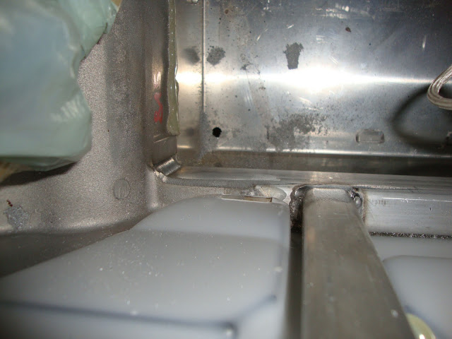

will need to trim these gussets at the rear bulkhead though

The 40aha cells look like they will fit in the height under the seat 2 high on their ends. deleting the stepthru is an option but probably only necessary with the 60ah cells. See antiscabs vectrix thread

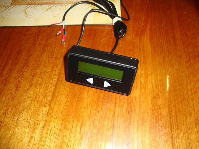

for the moment I'm using a different charger on my pack (an elcon 1500W)
The Vectrix charger needs the batt temp boards to be reporting pack temperatures to the CAN bus to work.
I'll start work on some boards to send fake temps to the CAN bus soon (but don't hold your breath)

I note you had to grind away part of the frame....is there any risk that you will burst the frame if the batteries swell up? That could be nasty.

Really minimal material removed, a little gusset and the weld high spots (proud of the tubes) I don't think it will have weakened the structure significantly. swelling cells on the chassis rails is new ground, so probably something that we need to monitor and report back on if we have any trouble.

ground the chassis today
taped up the controller with plastic to exclude aluminium dust, then vacuumed up all the mess.
I think this needs doing so the lugs don't interfere with the cell cases at the back. Not much room left with 15 cells front to back
I knocked all the high spots off the welds in the sides of the battery box too.
The vertical tubes at the second cells from the rear interfere with the tops of the cells that aren't well aligned.
Shuffling cells seems to work out ok

2 cells in this group 0.00 voltage, swollen and black celsidot. about 2000km on this
30 in, 12 to go.
I need to make up some strips to sit on the bottom row and support the next layer
I will use the stock anderson plug to split the pack 15,15,12.
the two 15 cell strings here show 50V each. Should make about 140V to start with.

Arrived in the mail today
CycleAnalyst
I'll be much more comfortable with this. instantaneous current Wh used displayed. Lots of other data available to play with
now, out to the shed :)
