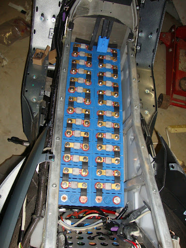

Like a kid at christmas
Old batts out, playing with fit of the new ones. Like a kid at christmas :D
Looks like 30 in the bottom layer mounted conventionally and, in the next layer, 12 more stacked 2 high on their sides will fit fine in the standard battery space.

ground the chassis today
taped up the controller with plastic to exclude aluminium dust, then vacuumed up all the mess.
I think this needs doing so the lugs don't interfere with the cell cases at the back. Not much room left with 15 cells front to back
I knocked all the high spots off the welds in the sides of the battery box too.
The vertical tubes at the second cells from the rear interfere with the tops of the cells that aren't well aligned.
Shuffling cells seems to work out ok

30 in, 12 to go.
I need to make up some strips to sit on the bottom row and support the next layer
I will use the stock anderson plug to split the pack 15,15,12.
the two 15 cell strings here show 50V each. Should make about 140V to start with.

The last 12 connected
As they will fit in the bike
still have to do the spacers, connect and solder the CMs, fit the Master unit and rig up an inrush current limiter

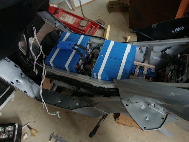

Just fitfed bits of an old kitchen to the bike...

hmm, two minor SNAFU's.
1. connected the anderson plug with the controller endo of the battery still open circuit to see that all was well. 51V... I had hooked each plus +ve and -ve to the sub pack +ve and -ve's. The 12 cells on top were reversed. some times it pays to be curious.
2. the top packs sit 40mm above the chassis rail. the stock pack was 32mm. I'll see if I can space the battery box lid up and still have the cover and seat fit reasonably

not gunna work.
I'll try 3 packs of 4 cells. Will fit easily but I'll have to work out the connections. that'll make 17,17,8 split at the anderson plug, not as good but workable

another trial fit
the Master control box looks like it will just fit under the extra bit of clearance at the front of the battery box.
I have to route the mains to the charger in between the front two stacks.
