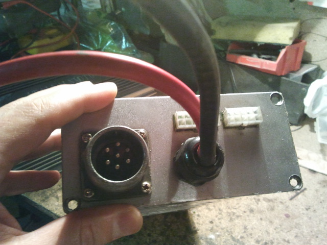

Controller controller! So I tried. I pulled out the controller, removed all the screws, banged and pried but the thing would NOT come apart. Looks like Zap didn't want you to get in there. So, I put it back for now. On a similar note, I started prepping for the 6th battery in front of the footwell battery. Widened the frame rails and built a few galvanized steel brackets. Battery fits great. Have to cut out the lower plastic dust/water shield and the footwell Dc-DC box for it to fit. I also relocated the DC-DC converter to just under the seat box so you can remove the little cover and get to the fuses easily. Then I stopped... Started thinking to myself, "what if I blow the controller or motor?", "how will this affect overall reliability?", "what if I breakdown 10 miles away?" Lol. Need some serious advice here on whether to proceed with the permo-72V mod or to just stick with 60V? As I've stated, initial testing proved the system can handle 72V with no major issues (only tested riding for a few miles). What to do.

Well, that's why I was applauding you for having nerves (or other body parts) of steel. If you blew either a motor or controller, (neither being readily available, as far as I know) the thing would be pretty much junk. You need to somehow find out what's in the box to see how close to disaster you're getting.
As I've mentioned, we got a bunch of the plastic body parts from ZAP! and have visited the junkyard that got the remains of the cannibalized scooters. I'll see if they have a controller that I can rip apart (and not be too upset if I break something) and do some research.
Will let you know.

The scooter here in Italy is a 2500W 6 phases and the controller is a 3000W. Do you have some pictures of your controller?
Find below some picture
Upgrading to lifepo4 - 21 cells
The controller - mine is a 3000W controller - Mosfet are TP152N -> 75A x 85V x 24 mosfet (6 phases)
The scooter completed
More details are here on my blog, unfortunately is in Italian

Some additional info regarding my "Zapino":
The voltage while runnig is around 64V-65V and keeps 61V-62V near the end of his capacity (80% DOD)
The speed on GPS with 21 cells is 70Kmh -> 43Mph
The controller give 60A/70A when taking off, at max speed is around 32A
The range at max speed is around 80Km -> 50miles
The name of the scooter is that
Elettra scooter 2500W
