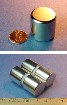

One powerful magnet could "be" the motor:
http://www.kjmagnetics.com/proddetail.asp?prod=DX0X0DIA
This is a watch patent which combines the Lavet motor and the Cam idea.

I'm assuming this magnet:
http://www.kjmagnetics.com/proddetail.asp?prod=RX04X0DIA
...looks like my hole size was too small.
The magnet is only 3.19 ounces (90.5 g) but the iron and copper would be about 3-4 pounds, so the whole thing would be about 5-6 pounds with sprocket. I'd mount it on the left side and include a freewheel, then use a PAS system for throttle.
